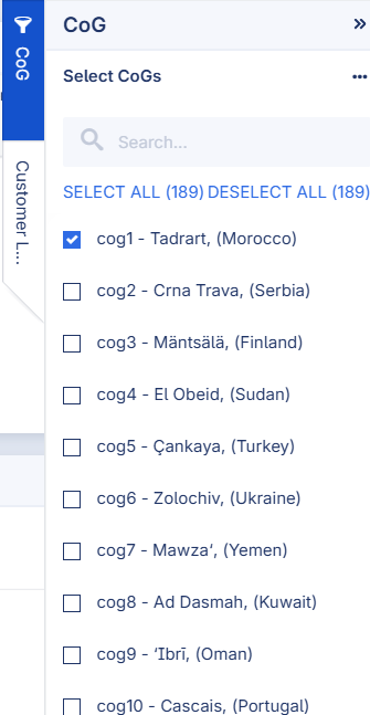

Filters
On the side panels CoG and Customer Location, it can be decided for each CoG and Customer Location whether to be shown in the tables or not.
../../../_images/cog_details_side_panel.png
